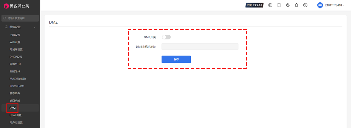

In the following three cases, DMZ mapping can be set in the upper-layer router or UPnP function can be enabled to improve the P2P success rate. (1) Install the computer host that logs in to the Aweseed software client; (2) The original network level cannot be changed, Aweseed the router is not a first-level dial-up route; (3) The Aweseed hardware used does not support broadband dial-up networking (such as bypass boxes, serial servers, etc.). ![](// upload-cdn)
Note: Only one of the two functions of DMZ and UPnP needs to be set; if it is in a multi-layer network structure, it needs to be set layer by layer.

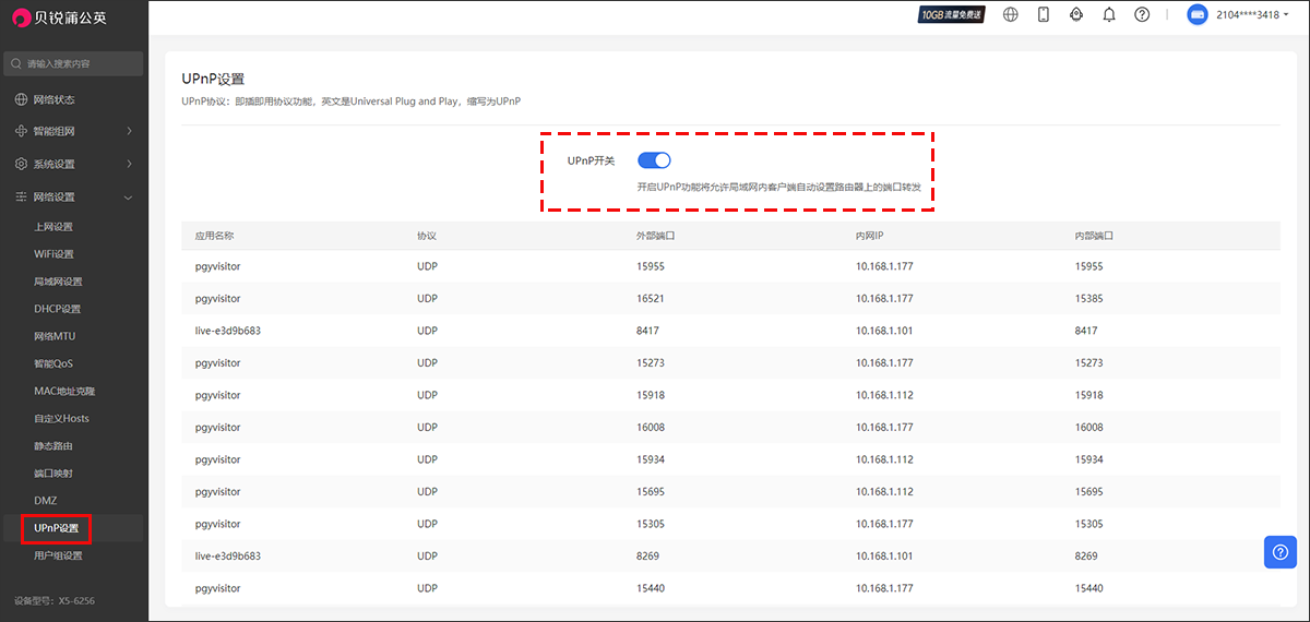

Through testing and research on a variety of routers, we summarize the methods of configuring NAT/UPNP/DMZ for your reference. #3. Aweseed (1) Log in to Router Cloud Management The browser opens the Aweseed cloud management platform, http://pgybox.com/, and enters the SN code and management password of the Aweseed router (the default password is admin) to log in

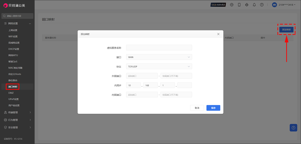

(2)NAT [Network Settings]-> [Port Mapping]]
(3) UPnP on [Network Settings]-> [UPnP]]
(4) Set DMZ [Network Settings]-> [DMZ]]

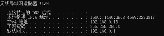

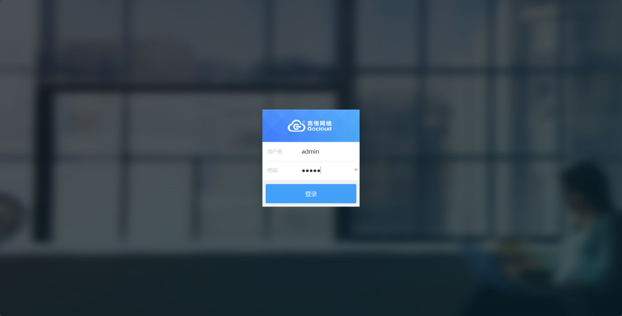

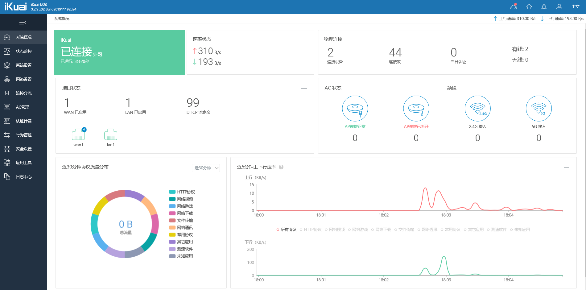

#4. Love fast (reference model iKuai-M20) (1) Login Router
  1. get router management IP: Win R -> enter cmd -> enter-> enter again: ipconfig
  2. Open the browser: Enter the router is the default gateway address 192.168.x.1

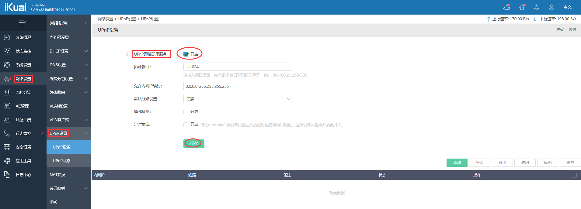

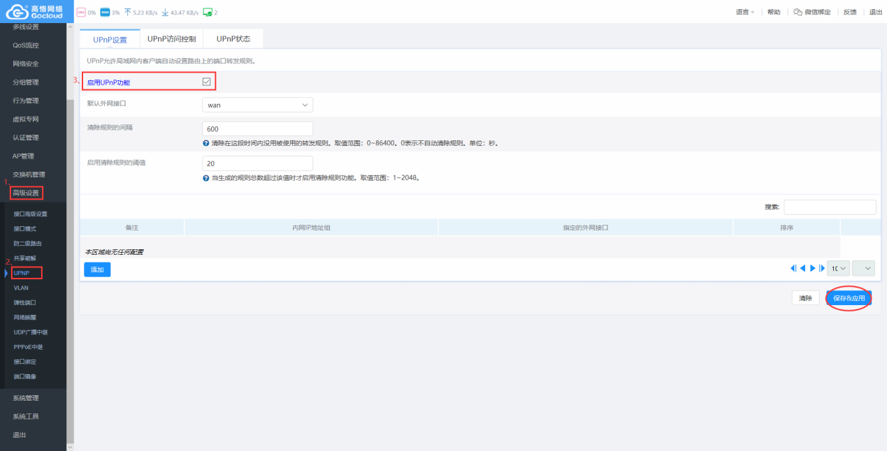

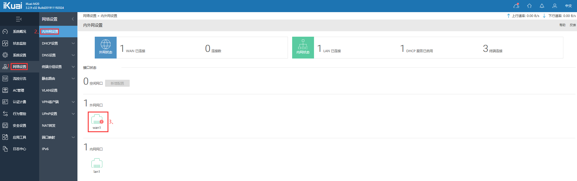

(2) UPnP on Click to enter "Network Settings"-> "UPnP Settings"-> "UPnP Plug and Play Service" = On

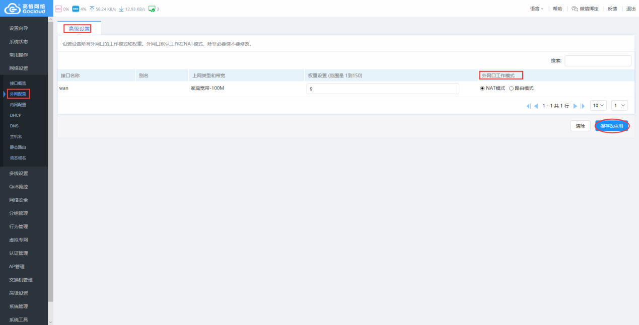

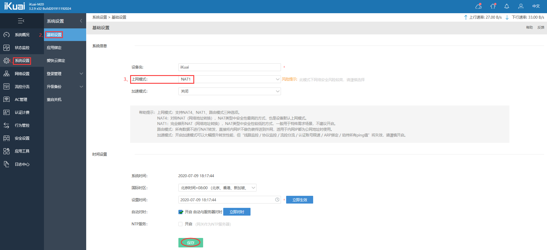

(3) Set NAT Adjust the device Internet mode to NAT1 (full cone type) Click to enter "System Settings"-> "Basic Settings"-> "Internet Mode" = NAT1

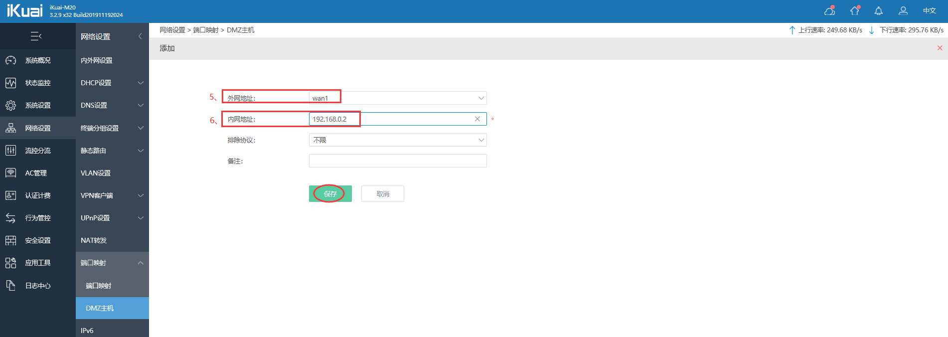

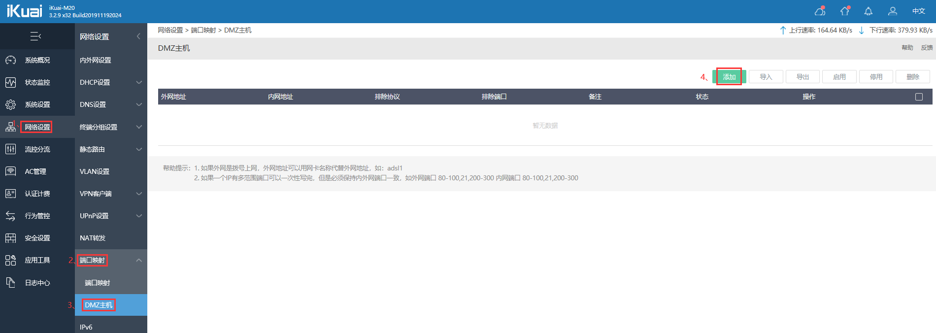

(4) Set DMZ
  1. Click to enter "Network Settings"-> "Port Mapping"-> "DMZ Host"-> "Add"
  2. "External Network Address", check "WAN1", that is, the Internet external network cable interface; "Intranet Address" = Private Network IP of the corresponding device, click "Save"

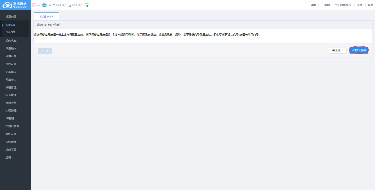

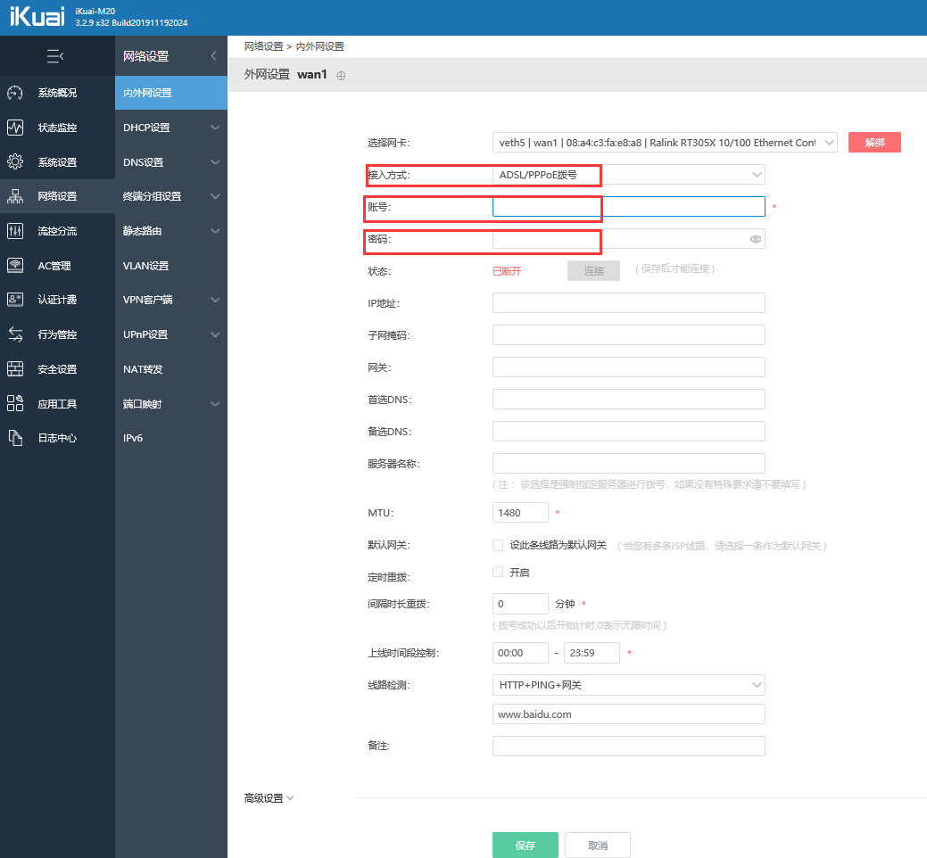

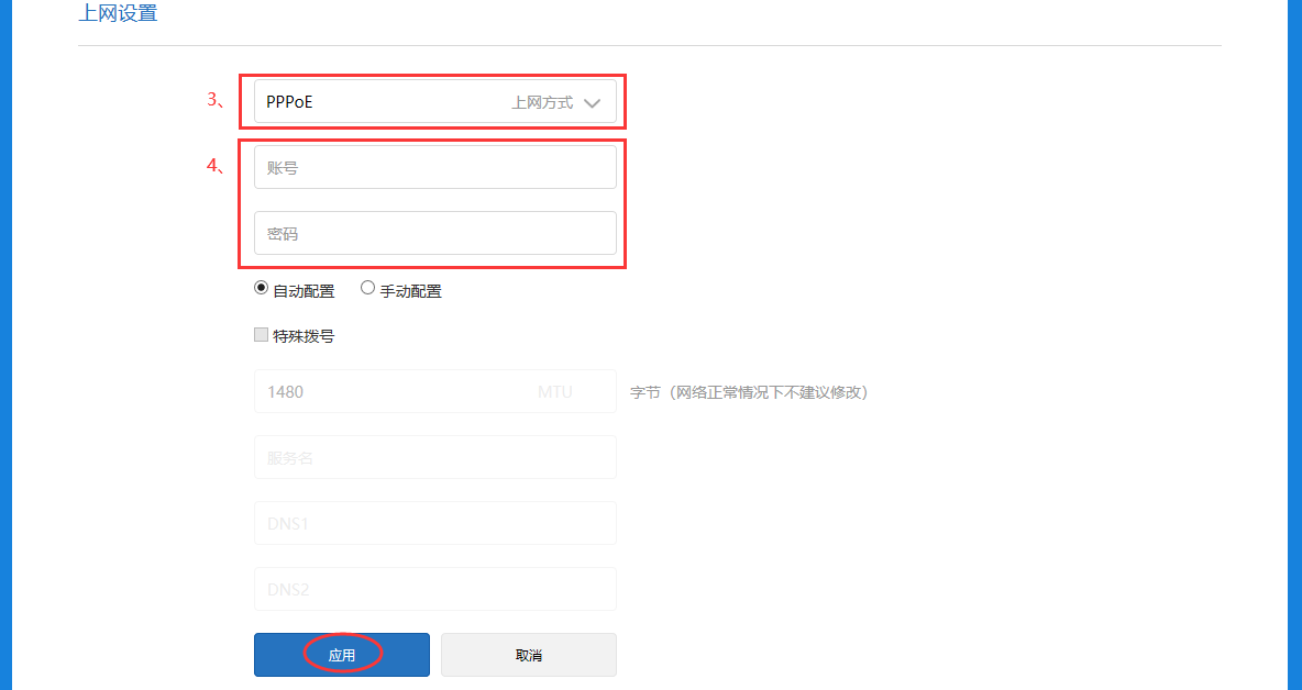

[Attached: dial-up settings]
  1. click to enter "network settings"-> "internal and external network settings"-> "external network port"
  2. click to select "access method" = ADSL/PPPoE dial-> "account number" = operator provided-> "password" = operator provided, click "connect" after "save"

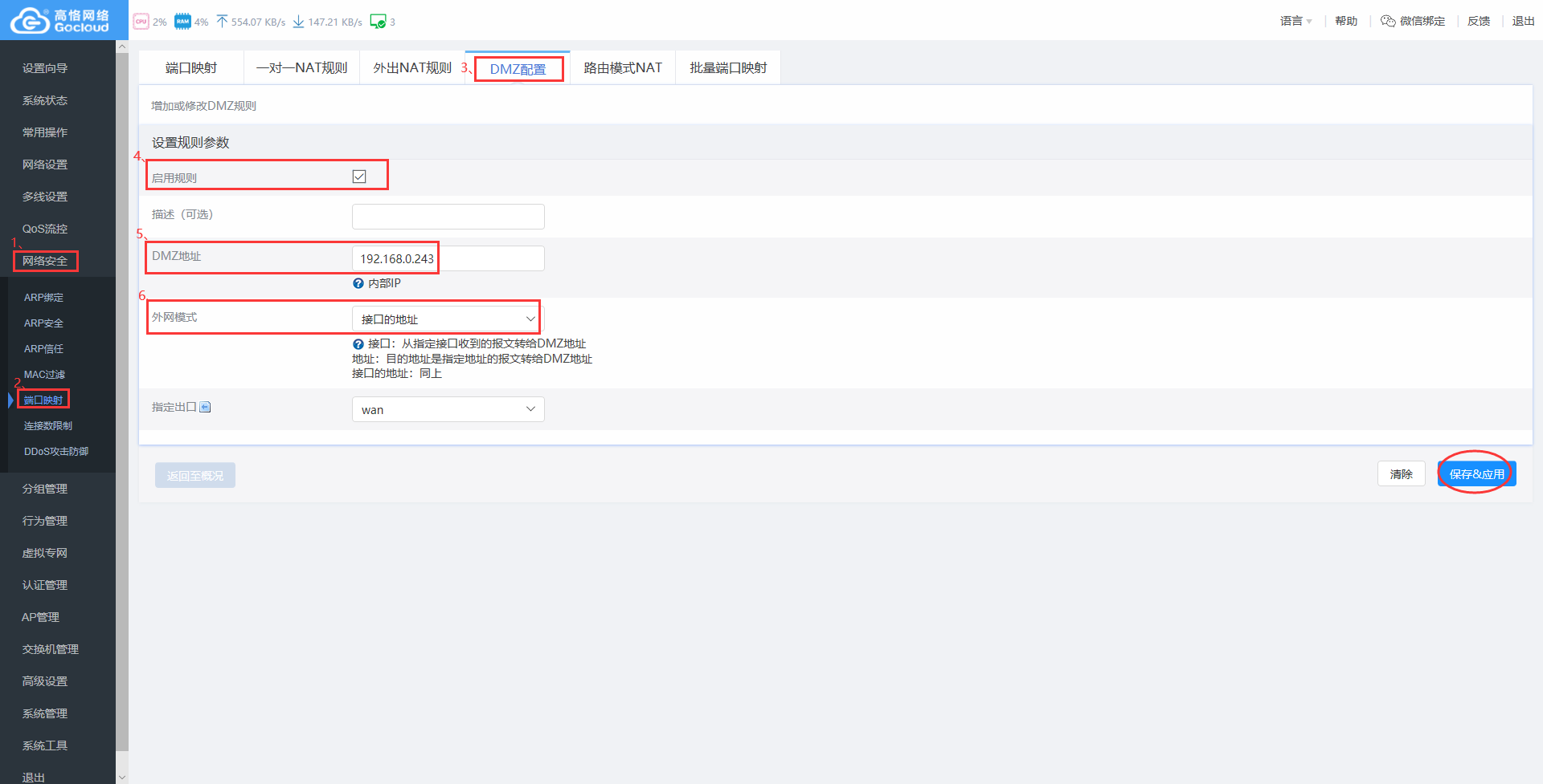

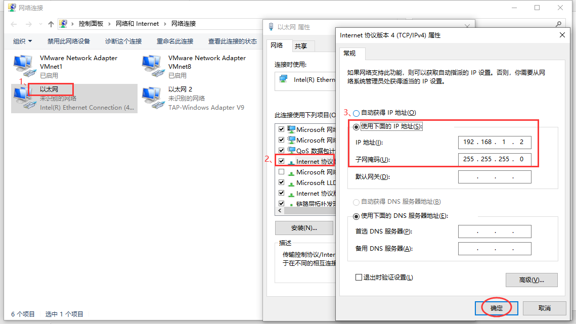

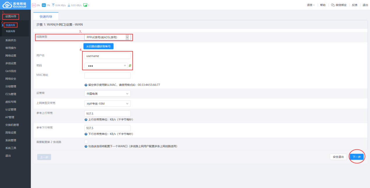

#5. High melt (refer to model AH-R10) (1) Login Router
  1. The LAN port is connected to the Ethernet port of the computer, and the IP of the computer is configured as 192.168.1.2/255.255.255.0
  2. Open the browser: Enter 192.168.1.1, the default account password admin/admin
(2) UPNP ON Click to go to "Advanced Settings"-> "UPNP"-> "Enable UPNP Function" = Tick
(3) Set NAT Adjust the working mode of the external network port of the device to NAT, click to enter "external network configuration"-> "advanced settings"-> "external network port working mode" = NAT mode, and click "save & apply"
(4) Set DMZ Click to enter "network security"-> "port mapping"-> "DMZ configuration"-> "enable rules" = check-> "DMZ address" = the private network IP of the corresponding device, and click "save & apply"

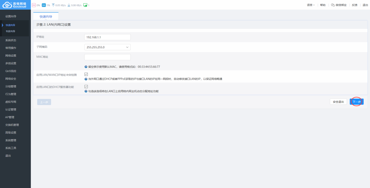

  1. Click to select "Setup Wizard"-> "Quick Wizard"-> "Line Type" = PPPoE Dialer (or ADSL Dialer) -> "User Name" = Operator Provided-> "Password" = Operator Provided, continue to click "Next"
  2. Continue to click "Next"
  3. Click on "Save & Apply"

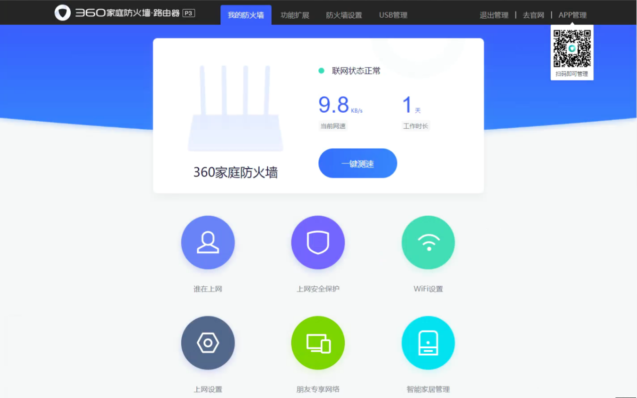

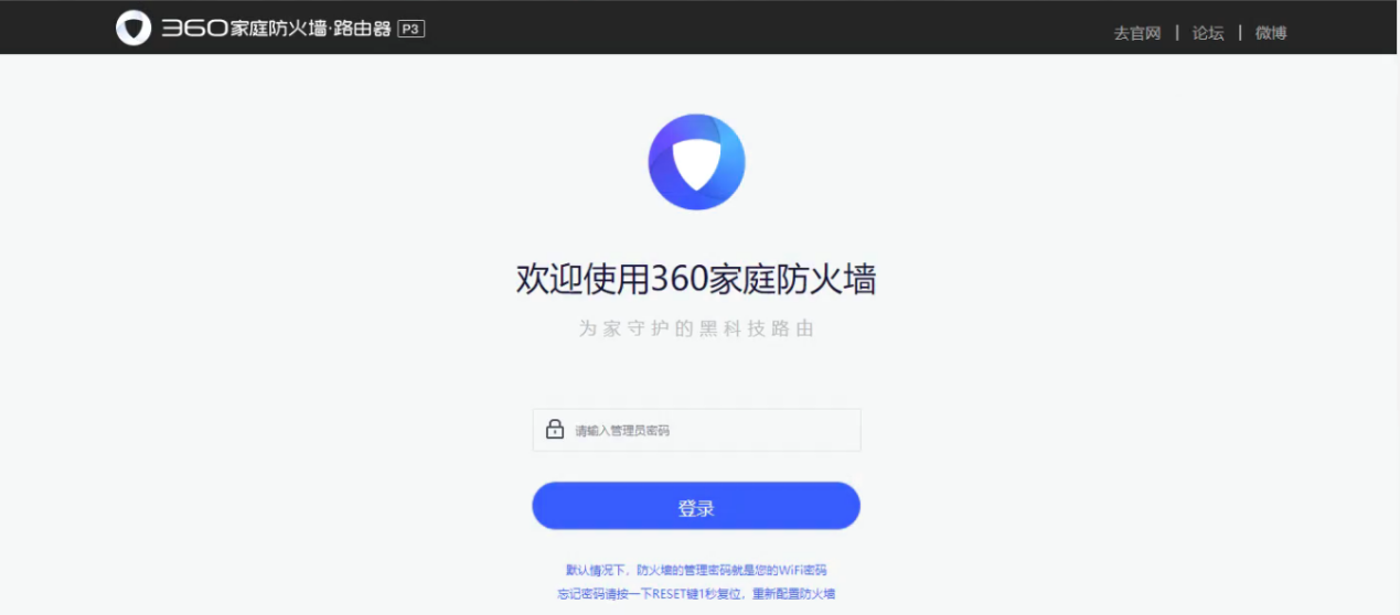

#6. 360 a secure router (1) Login Router
  3. Enter the password. After logging in successfully, the home page is as follows:

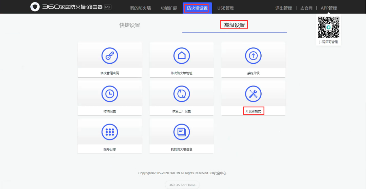

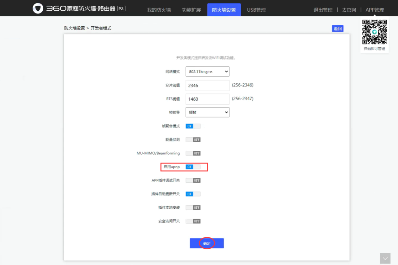

(2) UPNP ON
  1. Click to enter "Firewall Settings"-> "Advanced Settings"-> "Developer Mode"
  2. Click "Enable upnp" and "OK" to save the configuration

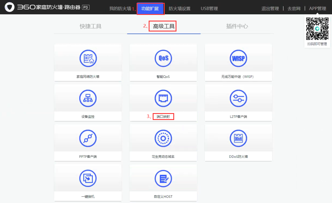

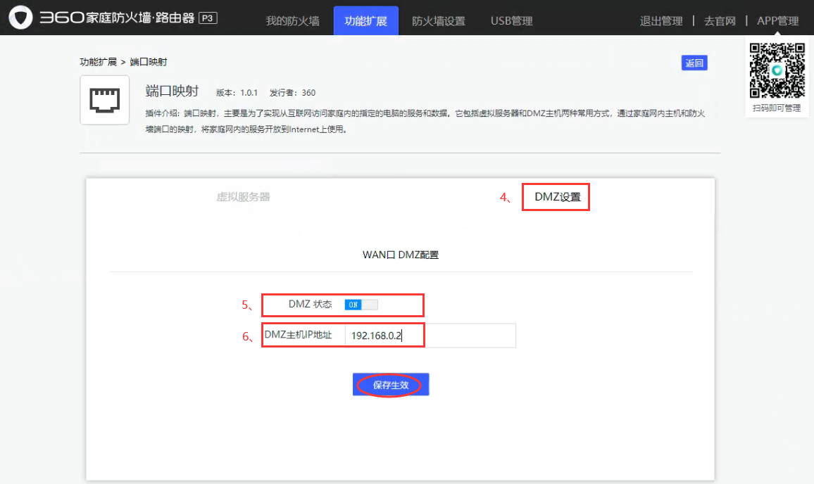

(3) Set DMZ
  1. Click to enter "Feature Extension"-> "Advanced Tools"-> "Port Mapping"
  2. click to enter "DMZ settings"-> "DMZ status" = ON -> "DMZ host IP address" = private network IP of the corresponding device, and finally "save and take effect"
[Attached: dial-up settings] "Home" Click to enter "Internet Settings"-> "Broadband PPPoE" Enter "Account/Password" and finally click "OK"

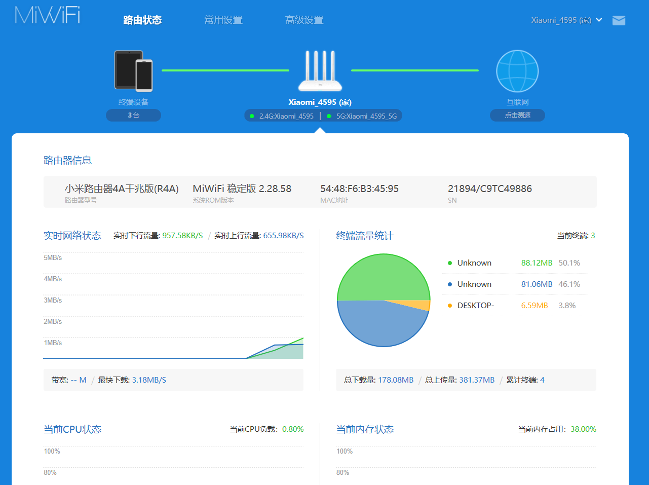

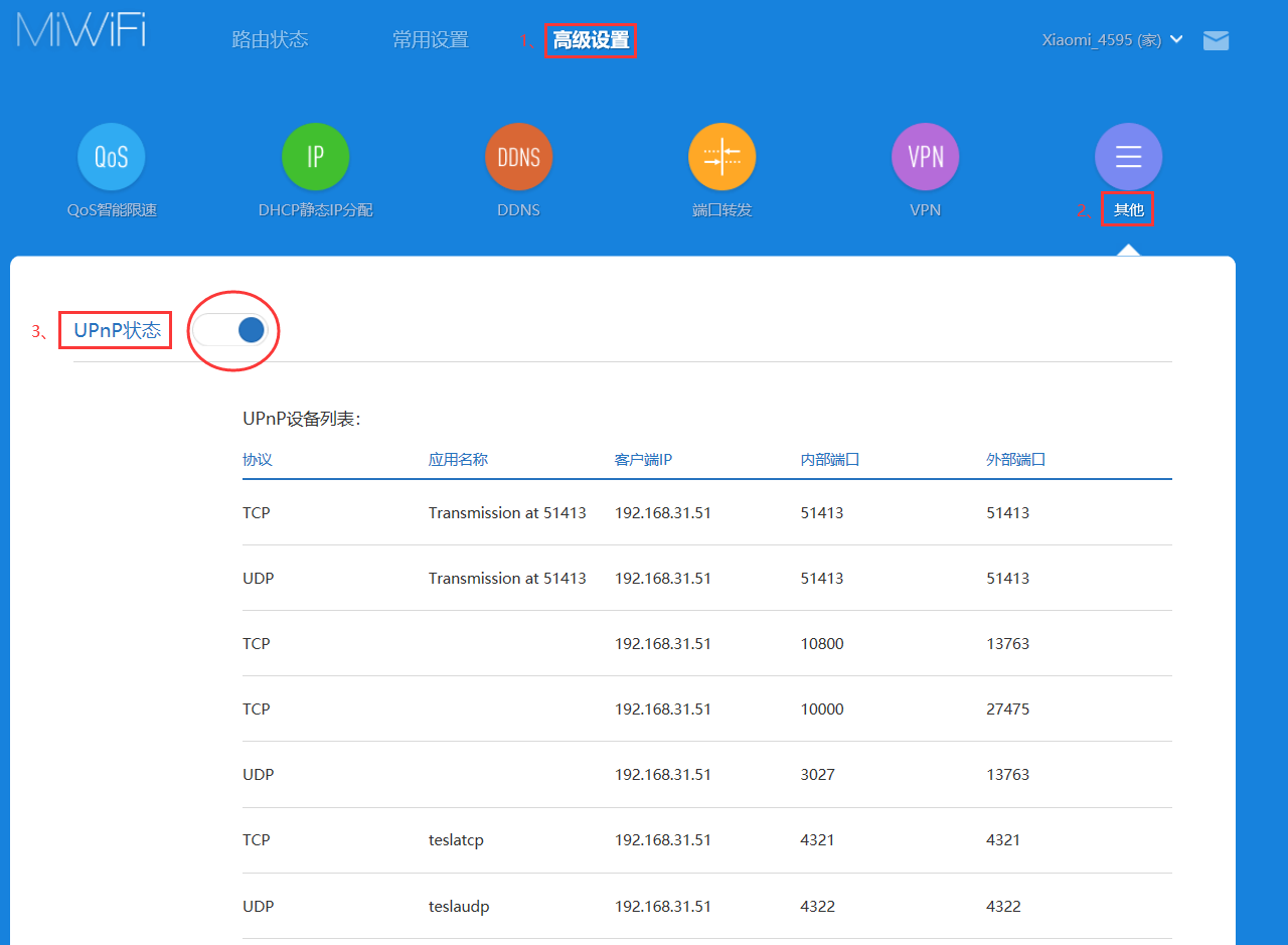

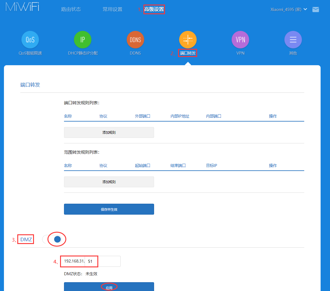

#7. Xiaomi (reference model Xiaomi Router R4A) (1) Login Router
(2) UPNP ON Click to enter "Advanced Settings"-> "Other"-> "UPnP Status" = On
(3) Set DMZ Click to enter "advanced settings"-> "port forwarding"-> "DMZ" = open and fill in the private network IP of the corresponding device, and click "apply"
[Attached: dial-up settings] Click to enter "common settings"-> "internet settings"-> "PPPoE"-> enter "account/password", and finally click "application"

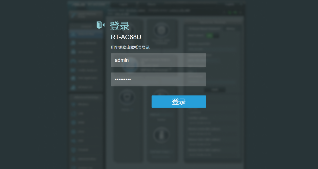

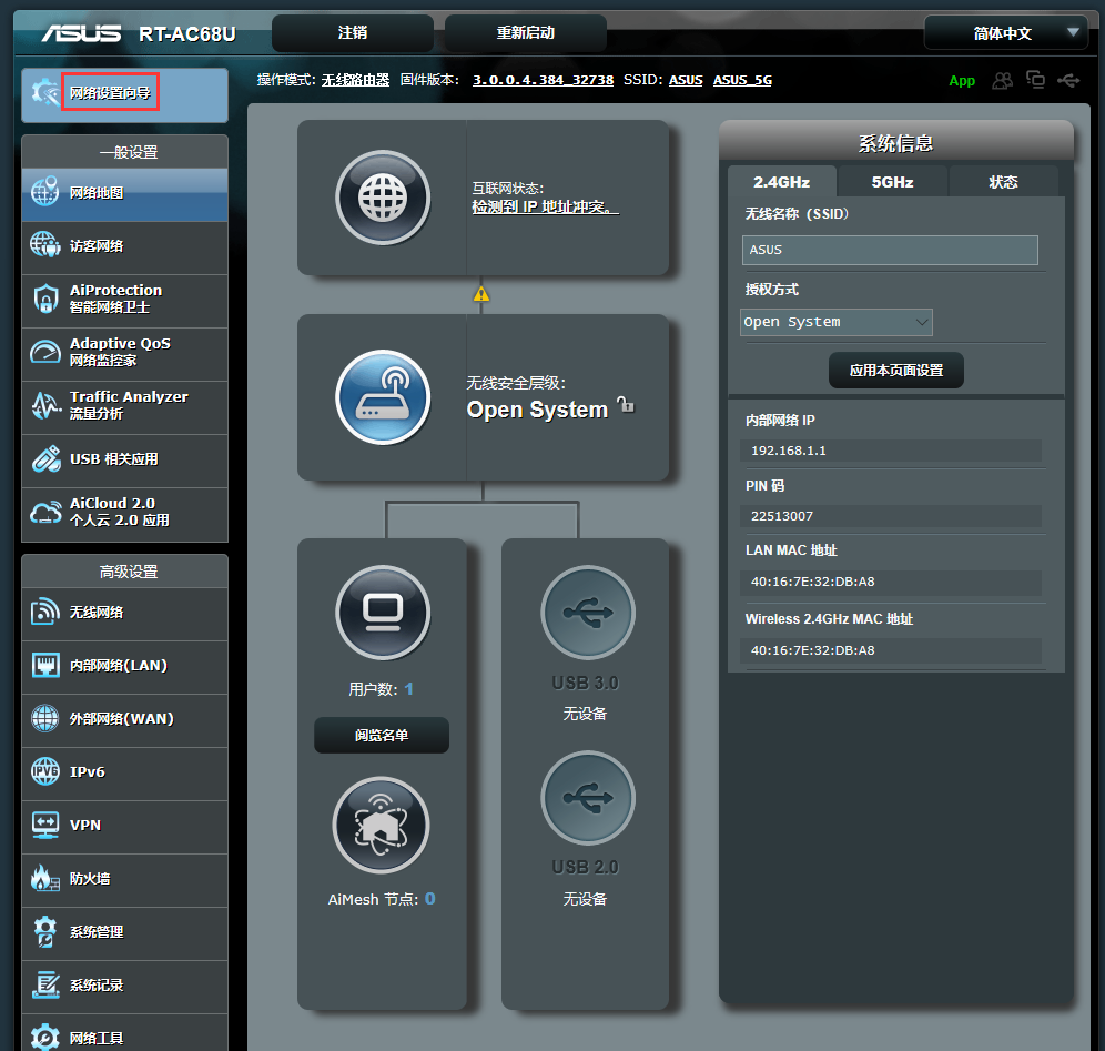

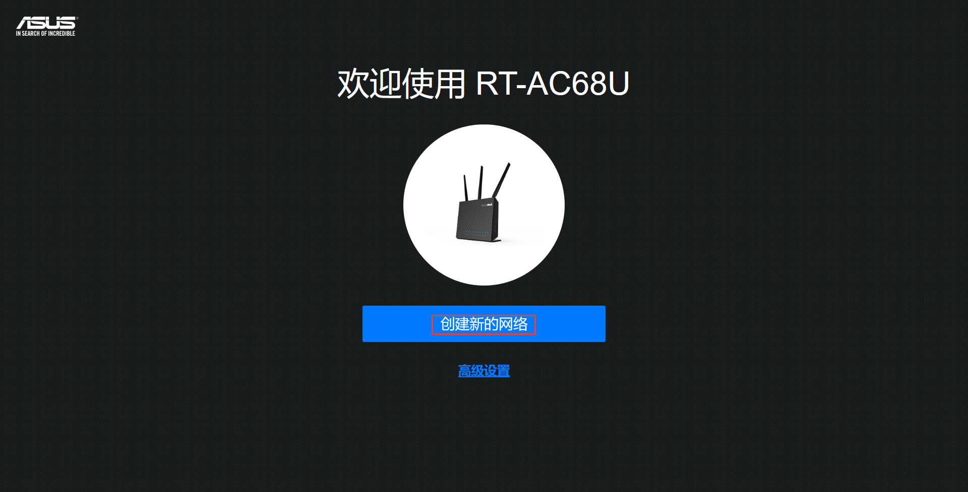

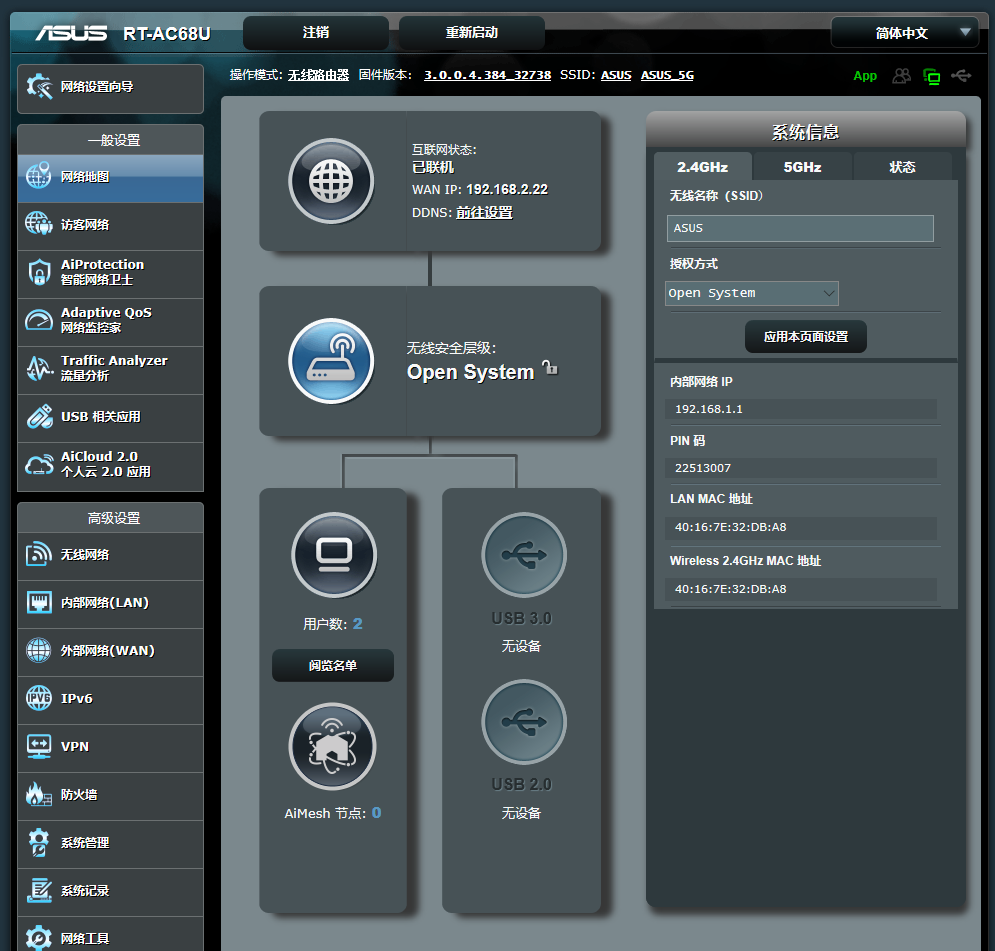

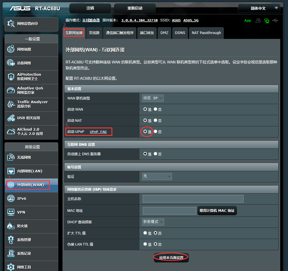

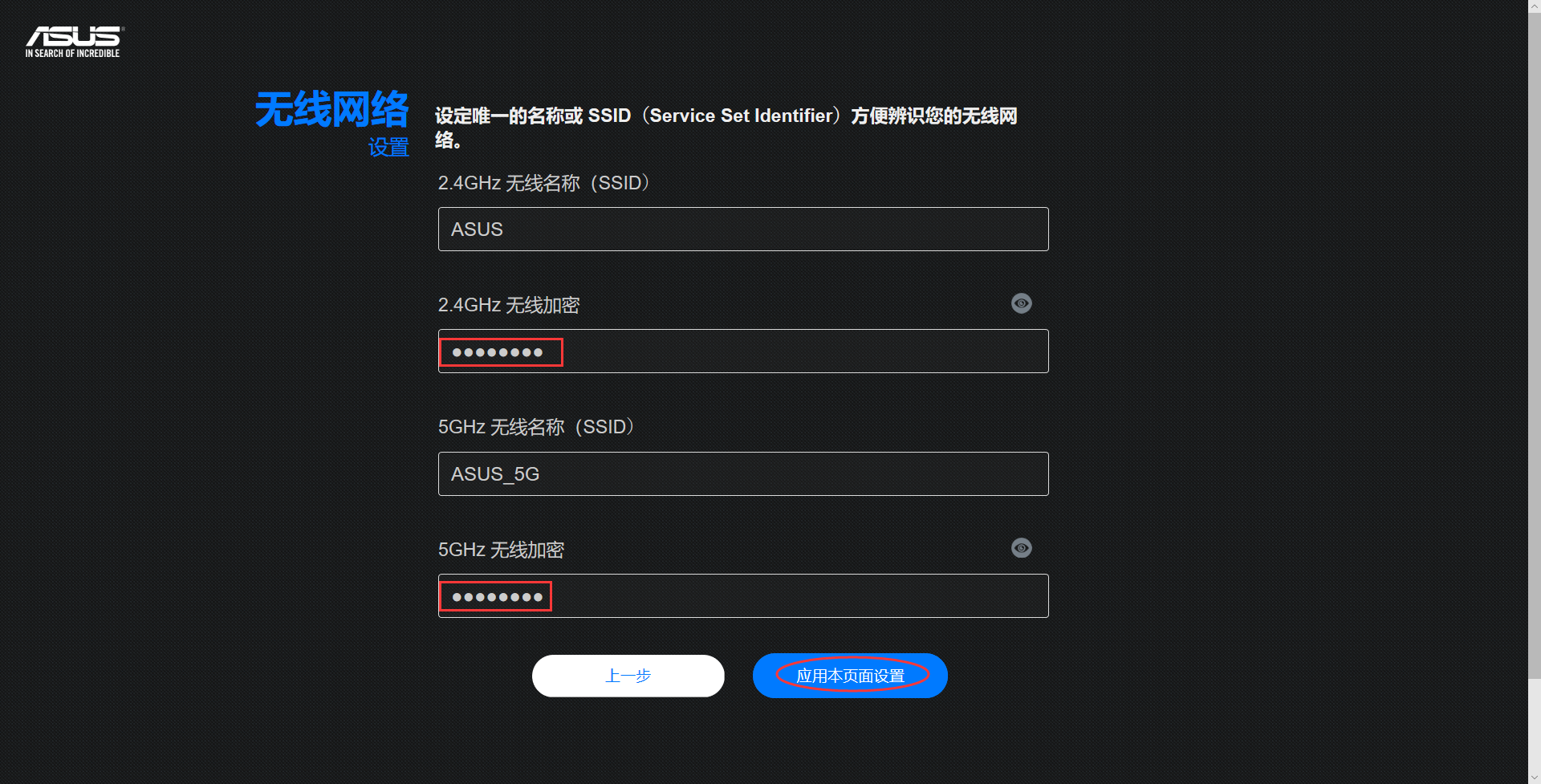

#8. ASUS (reference model RT-AC68U) (1) Login Router
  2. Open the browser: Enter the router, which is the default gateway address 192.168.x.1

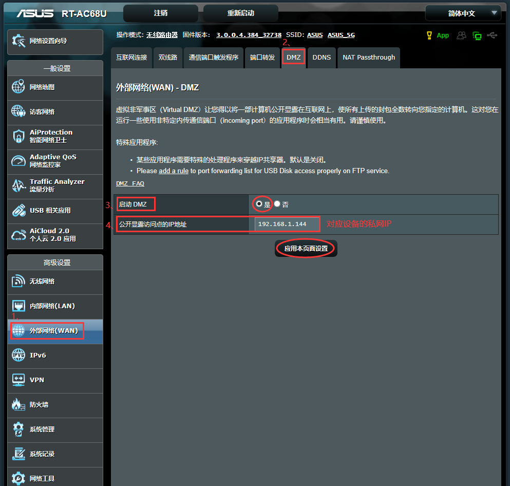

(2) UPNP ON Click to enter "advanced settings"-> "WAN"-> "internet connection"; Click "start UPnP" = "yes", and finally "apply this page settings" to save the configuration
(3) Set DMZ

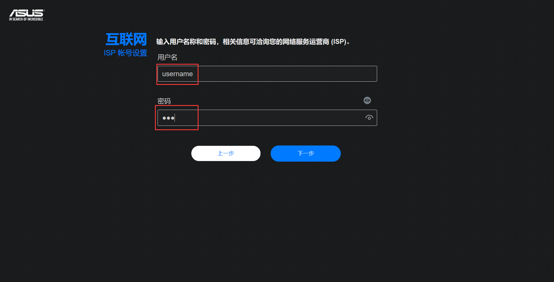

[Attached: dial-up settings] Click to enter the "network setup wizard"-> "create a new network"-> enter "account/password"-> set "wireless password", and finally click "apply this page settings"

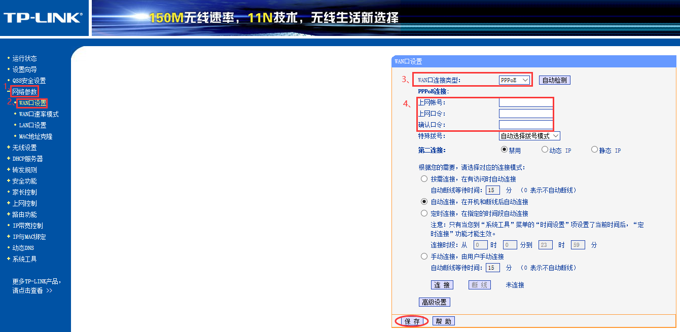

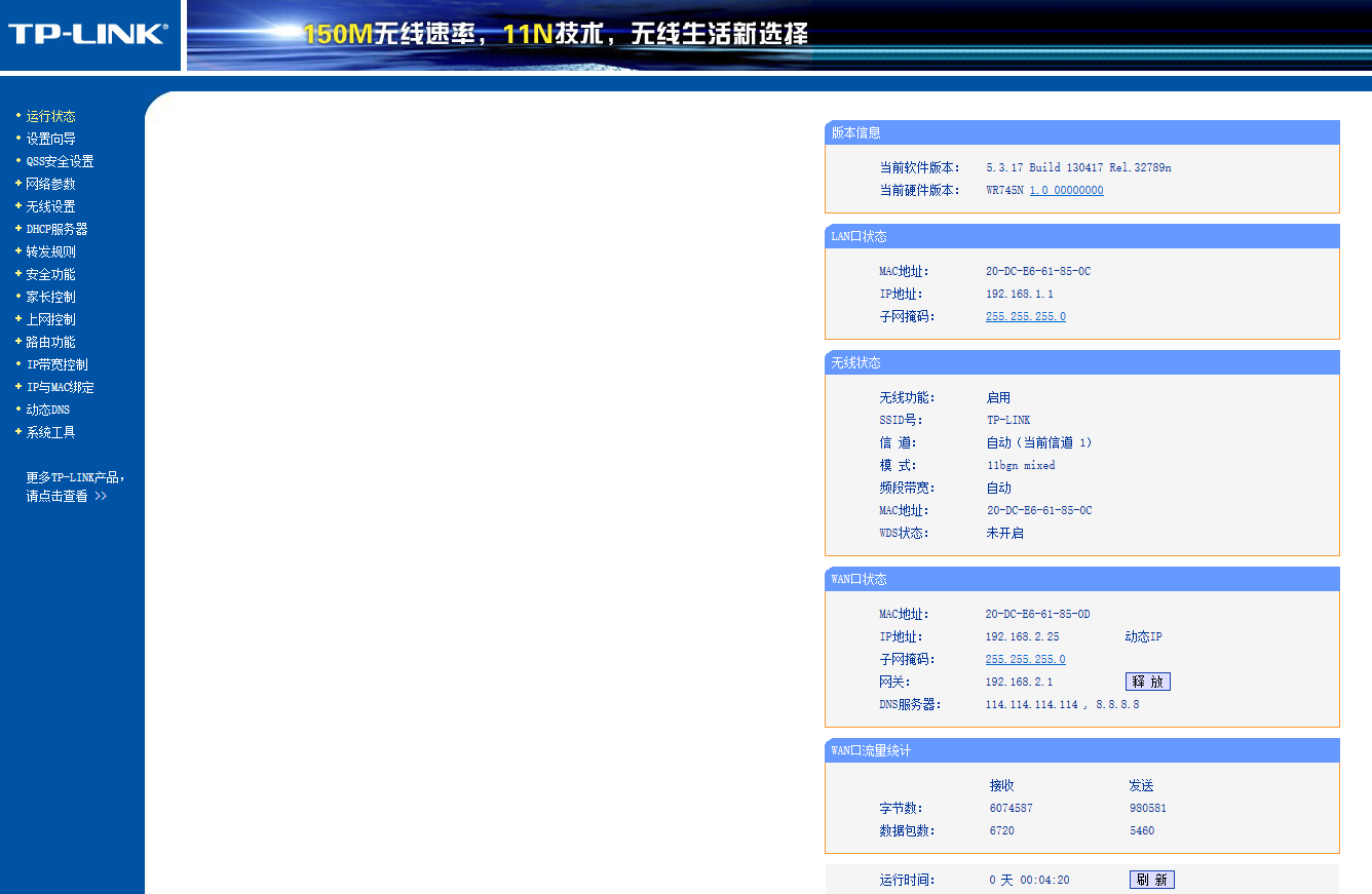

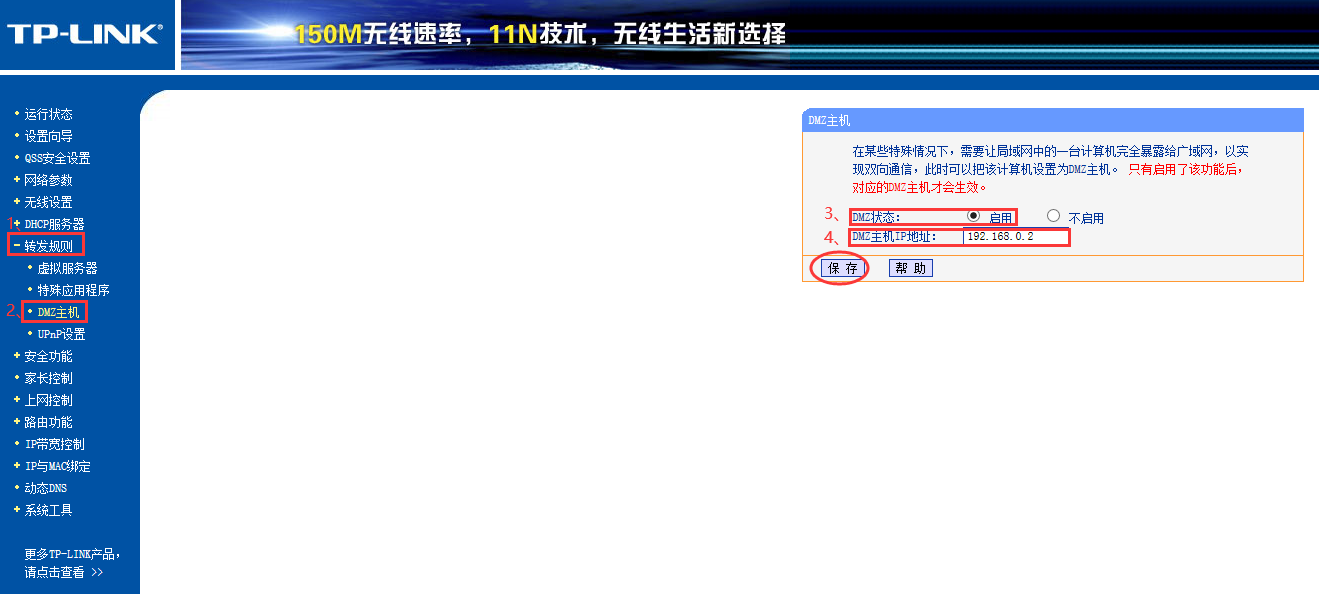

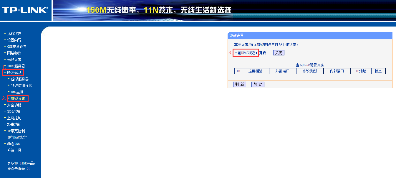

#9.TP-LINK (reference model TL-WR745N)
(2) UPNP ON Click to enter "Forwarding Rules"-> "UPnP Settings"-> "Current UPnP Status" = On
(3) Set DMZ Click to enter "forwarding rules"-> "DMZ host"-> "DMZ status" = enable-> DMZ host IP address "= private network IP of the corresponding device, and finally click" save"

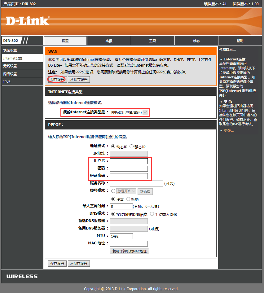

[Attached: dial-up settings] Click to enter "network parameters"-> "WAN port settings"-> "WAN port connection type" = PPPoE -> enter "internet account/internet password/confirmation password", "save" and click "connect"

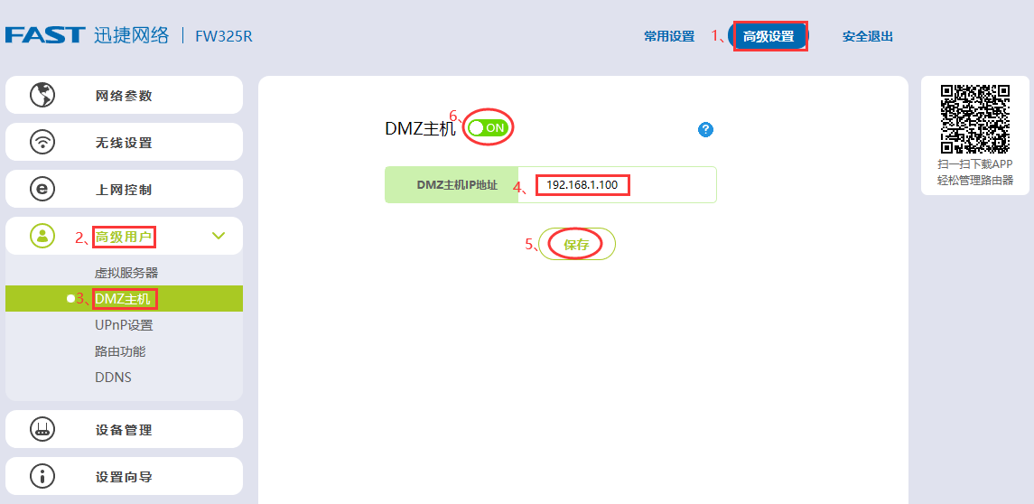

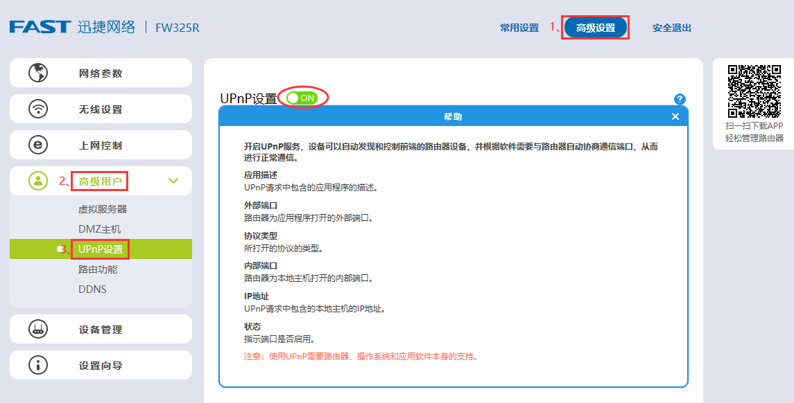

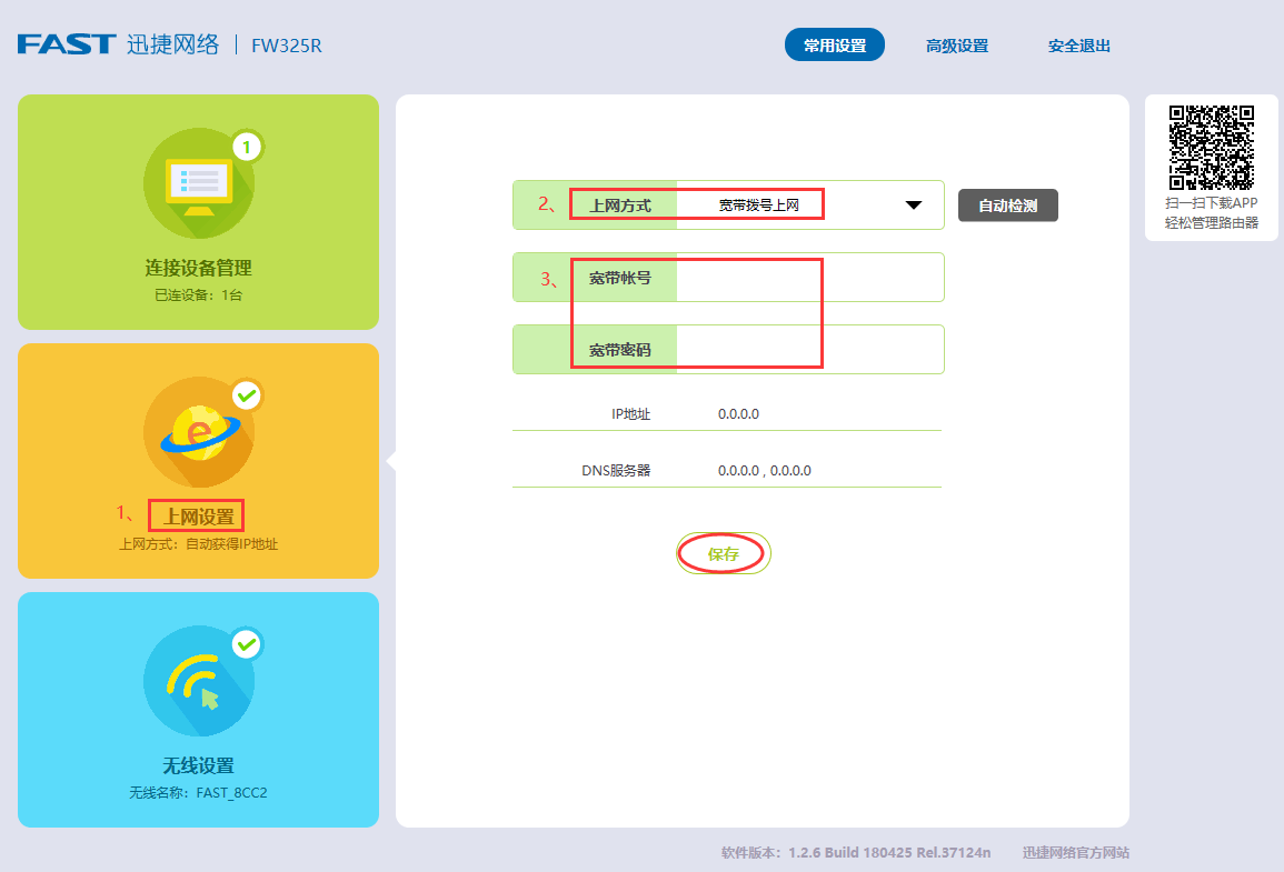

#10. FAST(FAST FW325R)
(2) UPNP ON Click to enter "Advanced Settings"-> "Advanced Users"-> "UPnP Settings" = ON
(3) Set DMZ Click to enter "advanced settings"-> "advanced users"-> "DMZ host", "DMZ host IP address" = private network IP of the corresponding device, click "save" "DMZ host" = ON, and finally "save"
**[Attached: dial-up settings]**Click to enter "internet settings"-> "internet access mode" = broadband dial-up internet access-> enter "broadband account/broadband password" and finally click "save"

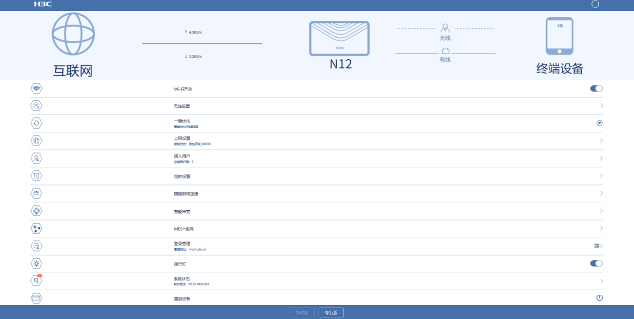

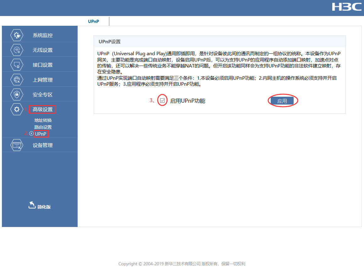

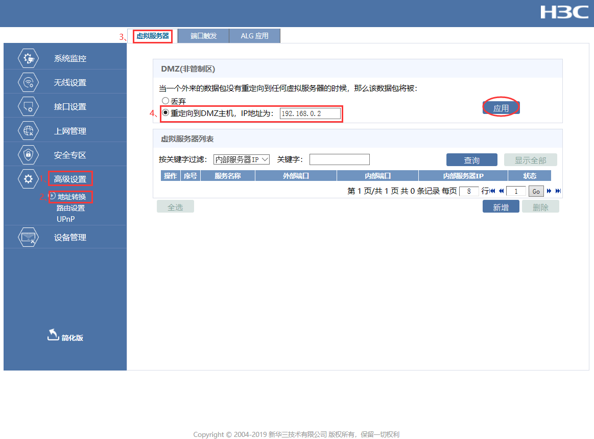

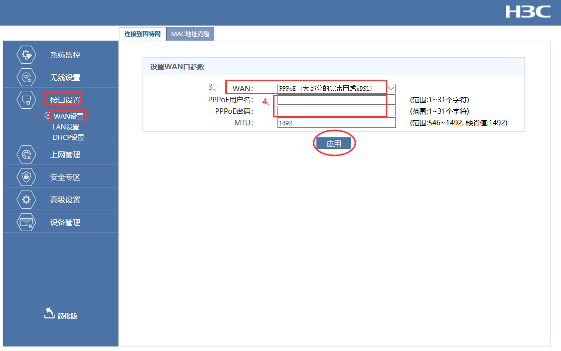

#11. H3C (reference model H3C N12) (1) Login Router
  1. Obtain the router’s management IP address: Press Win + R, type “cmd”, press Enter, then enter: ipconfig
  2. Open your browser and enter the router’s default gateway address, 192.168.x.1.
(2) Enable UPnP Switch to the professional version, click to enter "advanced settings"-> "UPnP"-> check "enable UPnP function", and finally click "apply"
(3) Set up a DMZ Click to enter "advanced settings"-> "address translation"-> "virtual server" and "DMZ (unrestricted zone)", check "redirect to DMZ host, IP address is" = private network IP of corresponding device, and click "apply"
[Attachment: Dial-up Internet Setup] Click to enter "Interface Settings"-> "WAN Settings"-> "WAN" = PPPoE -> Enter "PPPoE username/password" and finally click "Apply"

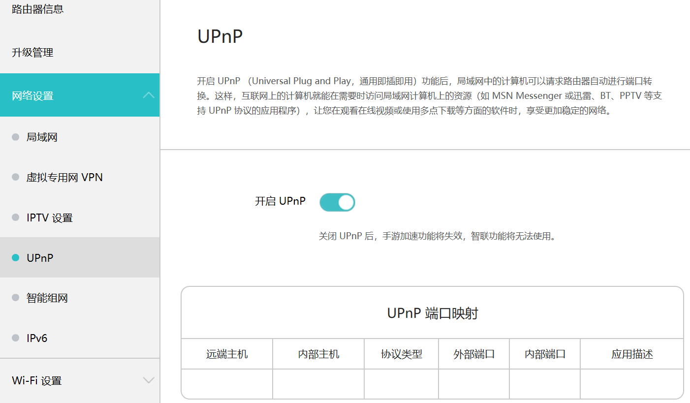

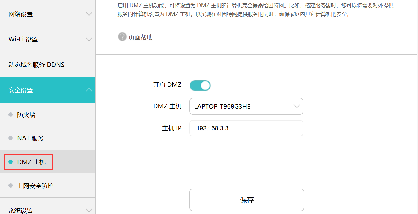

#12. Huawei (Reference Model Huawei Routing AX3) (1) Login Router
(2) Enable UPnP Click to enter "Network Settings"-> "UPnP"-> Open UPnP
(3) Set up a DMZ Click to enter "security settings"-> "DMZ host"-> "open DMZ" = check "DMZ host" = corresponding device, click "save"

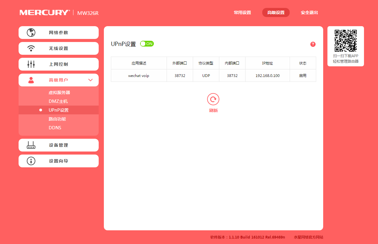

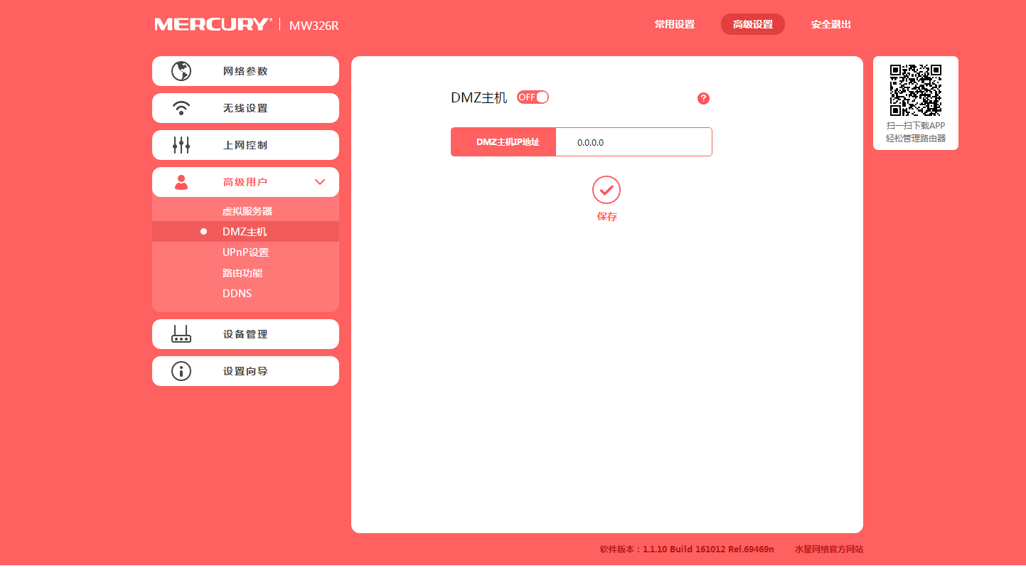

#13. Mercury (reference model Mercury MERCURY MW326R) (1) Login Router
(2) Enable UPnP Click to enter "Advanced Settings"-> "Advanced Users"-> "UPnP Settings" = ON
(3) Set up a DMZ Click to enter "advanced settings"-> "advanced users"-> "DMZ host" = ON "DMZ host IP address" = private network IP of the corresponding device, and click "save"

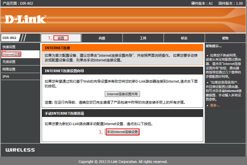

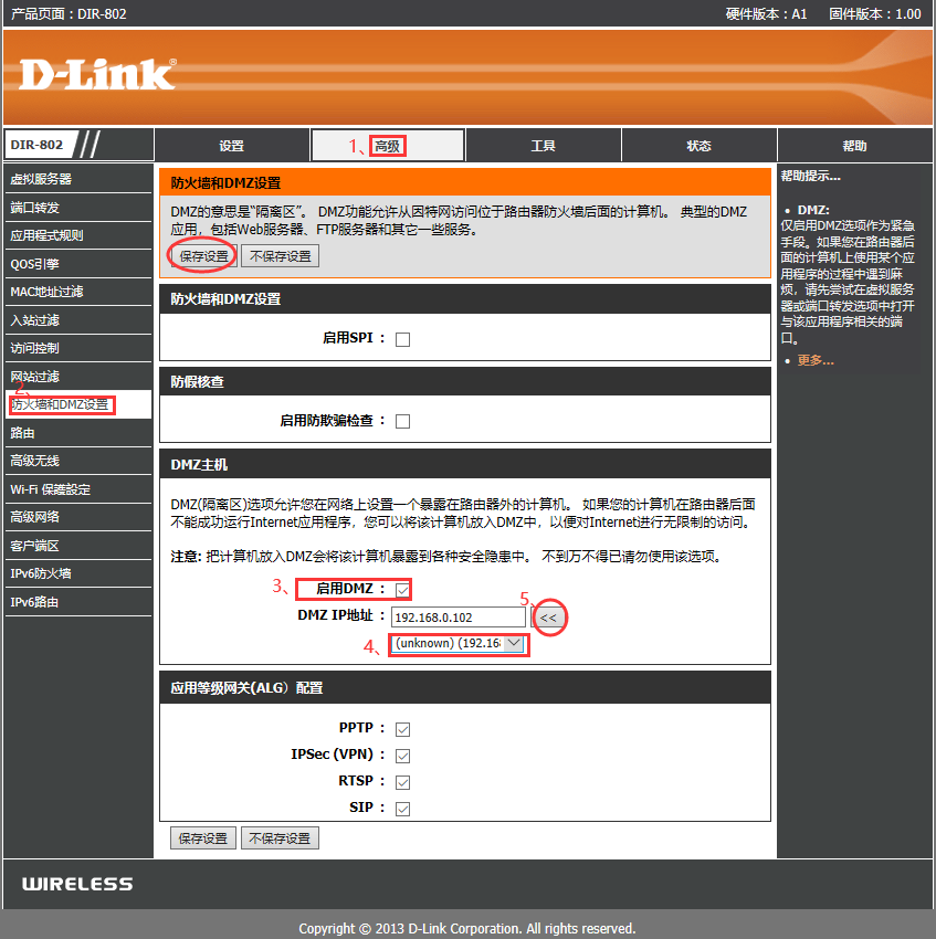

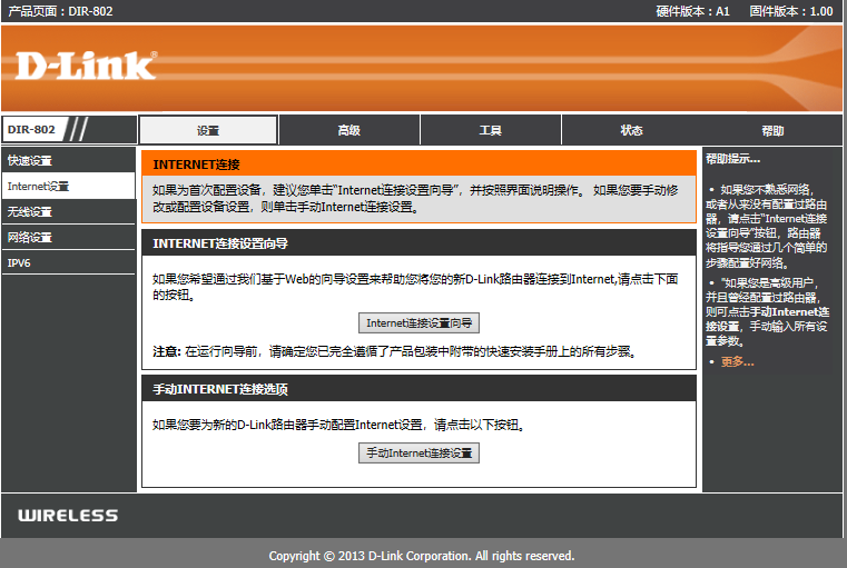

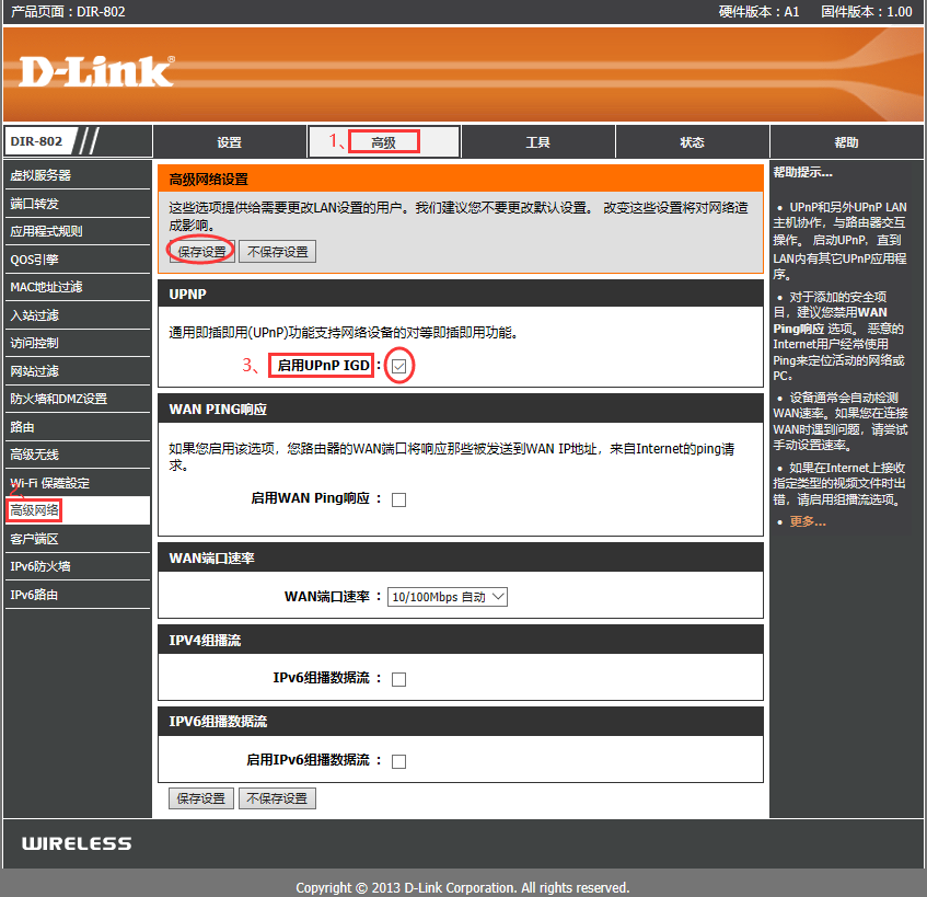

#14. D-LINK (reference model D-Link_DIR-802) (1) Login Router
  2. Open the browser: Enter the router, which is the default gateway address 192.168.x.1; Default user name: admin, password: empty
(2) Enable UPnP Click to enter "advanced"-> "advanced network"-> "UPnP" = check box, click "save configuration"
(3) Set up a DMZ Click to enter "advanced"-> "firewall and DMZ settings"-> "enable DMZ" = check and drop down = the private network IP of the corresponding device, click "<<", and finally click "save settings"

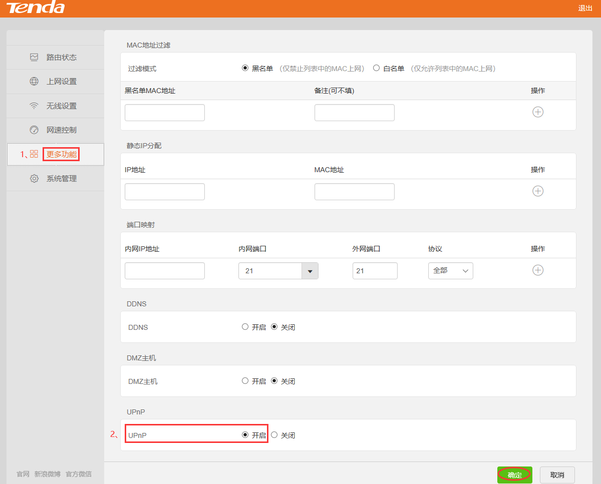

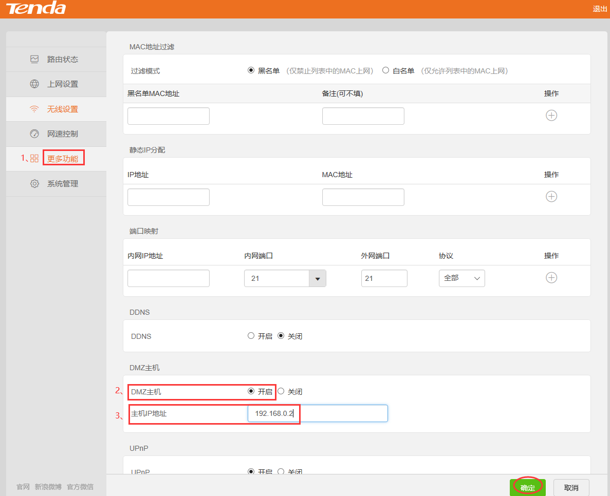

#15. Tenda (reference model Tenda F6v3) (1) Login Router
(2) Enable UPnP Click to enter "more functions"-> "UPnP" = open, click "OK"

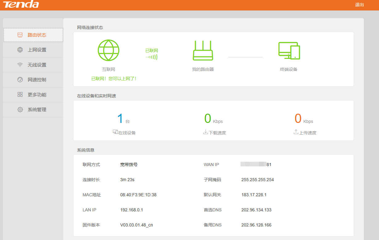

(3) Set up a DMZ Click to enter "more functions"-> "DMZ host" = open-> "host IP address" = the private network IP of the corresponding device, and finally click "OK"

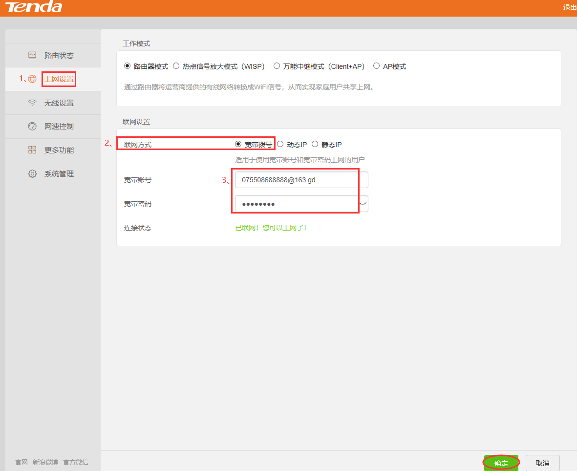

[Attachment: Dial-up Internet Setup] Click to enter "Internet Settings"-> "Networking Mode" = Broadband Dial-> Enter "Broadband Account/Password" and finally click "OK"

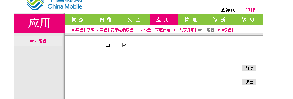

#16. Optical Cat Optimization Example 1 (Model China Mobile GM219) (1) UPNP ON
(2) Set DMZ

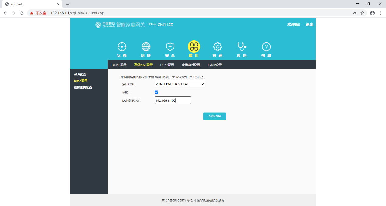

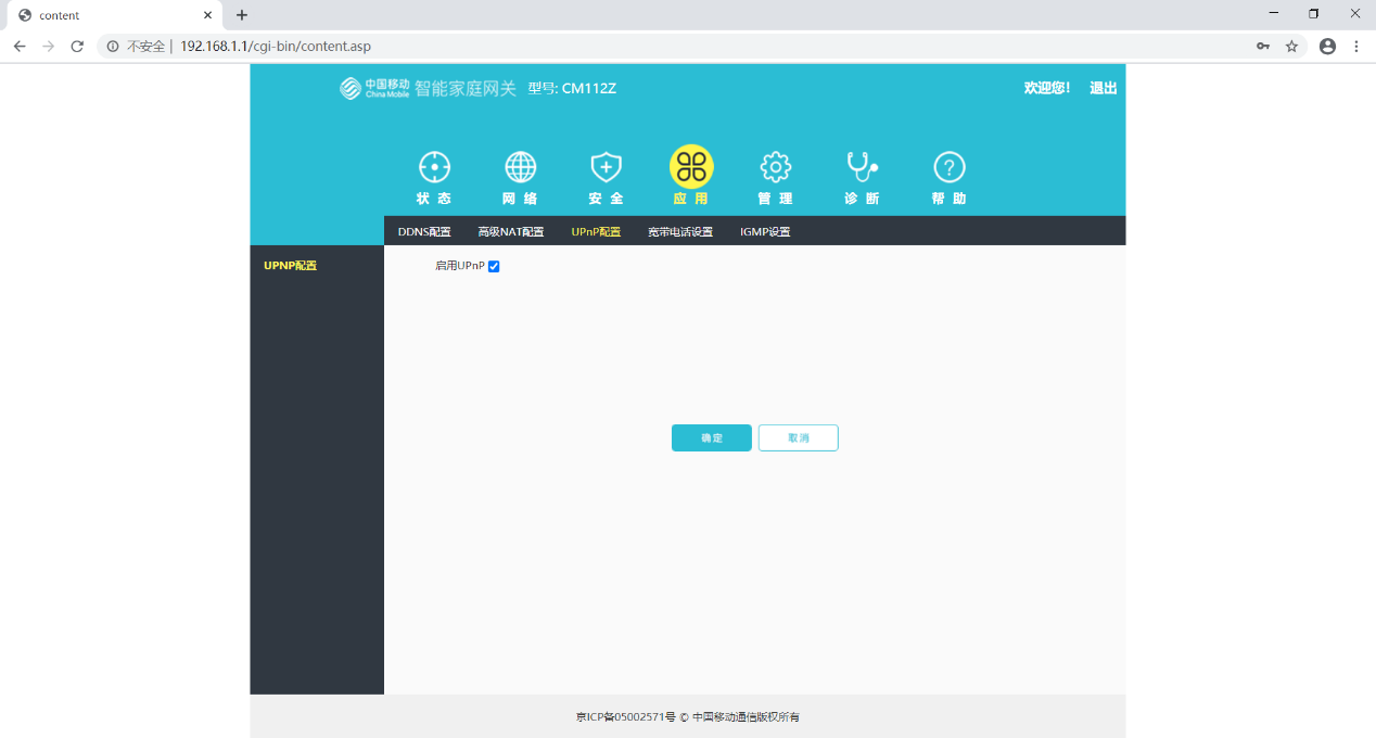

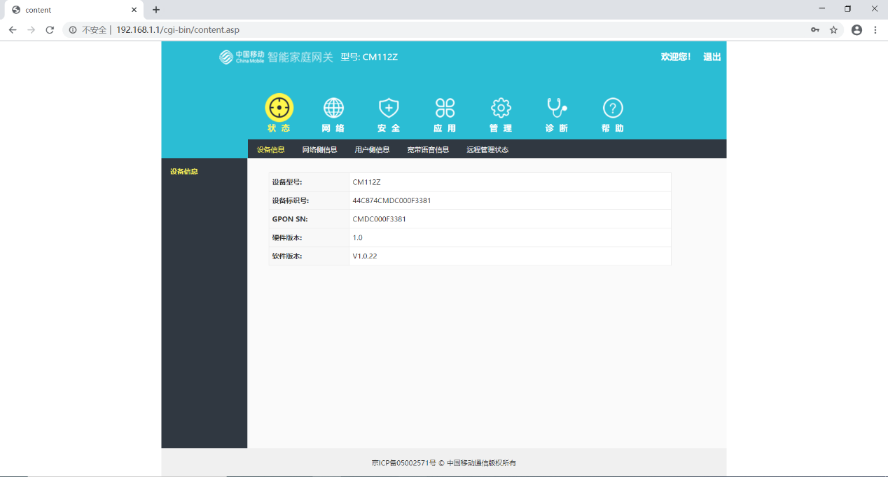

#17. Optical Cat Optimization Example 2 (Model China Mobile CM112Z)
(1) UPNP ON
(2) Set DMZ The operation of NAT/DMZ/UPNP may be different for different operators. For details, please consult the local operator.
