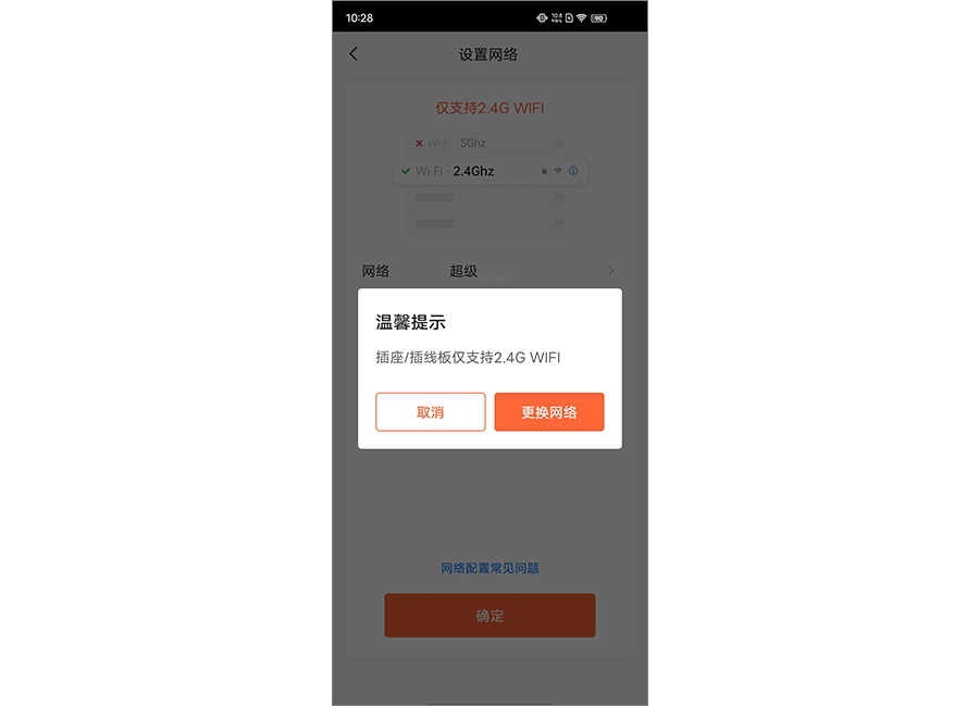

Question 1: Prompt only supports 2.4GWiFi
The control terminal APP adds a power-on socket. The following prompt is seen in the network setting link, which means that the WiFi currently connected to the mobile phone is not 2.4G channel. Please change the network and try again.
